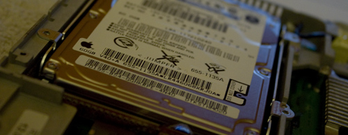

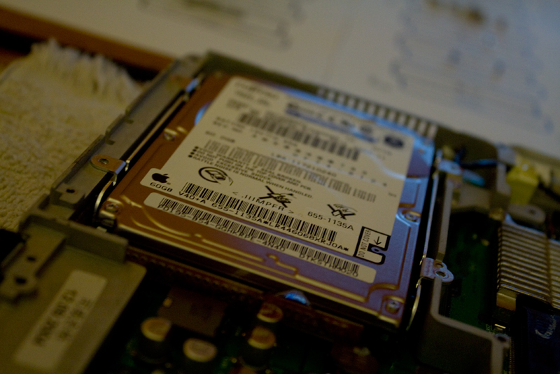

I was expecting the fix to take around 3 hours, after reading reports of it taking some people that long, but the actual drive replacement seemed to only take me around an hour and a half from first screw out, to last screw in.
The guides from Ifixit are a godsend, everything was simply explained and not to much info in each step, and the screw guide’s they have included in the PDF versions help you keep each steps screws separated so you can work through backwards and know where each screw goes. Of course, even with such a simple guide I still ran into a couple of problems, like forgetting to re attach the keyboards ribbon cable before screwing the ram cover on and re-installing the airport card. Luckily, that was only 4 or screws, though. No biggie, and I’m allowed one slip up. Right?

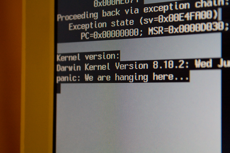

OK, I’ll try the 10.4 disc we have, again, but I just kept getting Kernel Panics. I was almost having a Kernel Panic myself at this point. Three hours into my fix, and I was stumped. Why the hell is it doing this? I’ve replaced the drive, and everything else is fine. Why are you doing this to me? I came to the conclusion the discs were for a Intel based Mac, and most probably tied to my MacBook somehow, so would be no good for me to use on the PPC iBook.

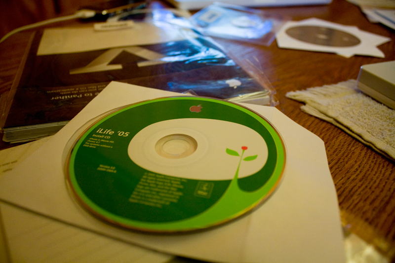

I went back to 10.5, as at least this one let me into disc utility. I partitioned the new drive, and gave it a name. Then, I had to search around in the loft of the house for the original discs that shipped with the iBook. Luckily, they were in view right as I went up there. Phew.
Dusting off the envelope which held all the original info that came with the machine, it was great to see how much Apple’s packaging has changed in just a few years. A huge Panther user guide, nicely designed iLife disc’s and some of the big Apple stickers you used to get. They seem to have shrunk them over the recent years, apparently. That is, if they’re even still bundled with things.

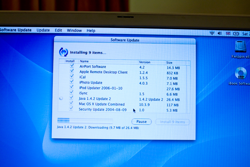

I insert them, and we have life! No more Kernel Panic on loading up the disc. No more “You cant use this disc as it’s an upgrade.” Just the sweet look of 10.3 loading onto the iBook. I gave a small cheer and a huge smile and sigh of relief. Once it was all installed, looking at the old OS was just like looking at the user guide. Oh, how they have changed. Not massive changes; just small UI changes.
What seemed like 50 system updates and countless restarts later it was back, my iBook was smiling at me once again and was begging to be used.
